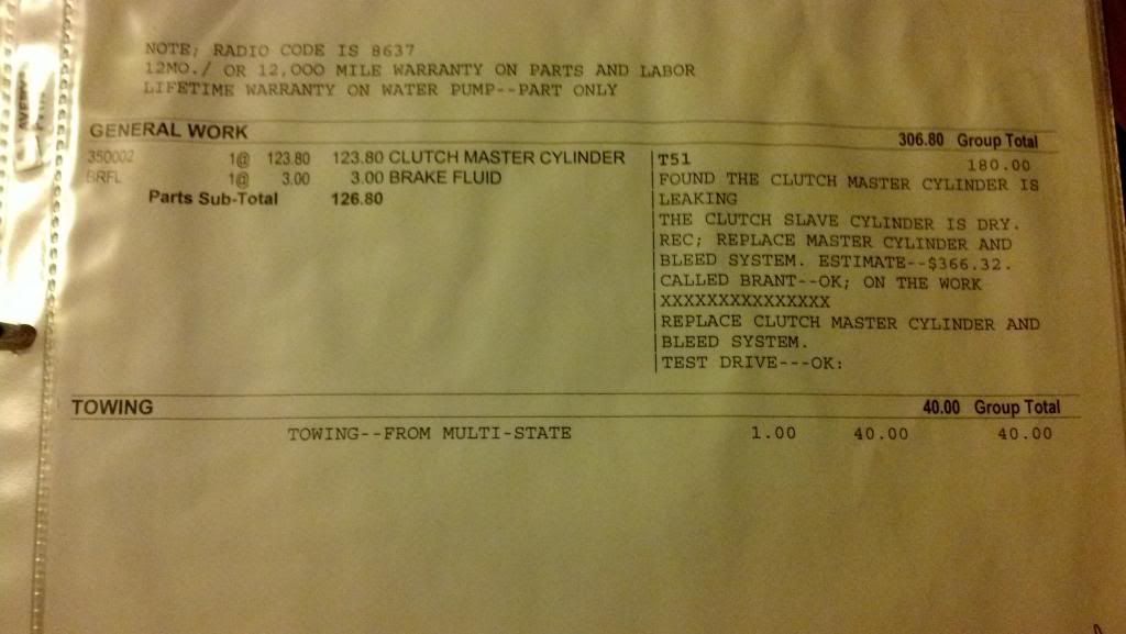

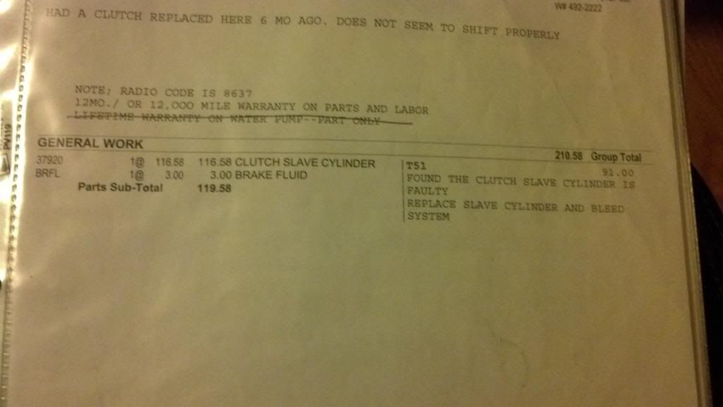

    I bought the car with 87k miles on it and at that time the master and slave cylinders had been replaced not only once but twice already. The previous owner gave me a binder with all of the previous work to the car.
    It seems to me that they never really fixed the original problem with the clutch system and this could possibly be causing all of the issues. Any suggestions on where to look?

    They lied to the previous owner and didn't replace the slave. If you are losing fluid you have a leak and most likely it's the slave. If not the slave then it's a line but I bet slave.
    Is this an NA or a TT? If it's an NA you can just check the carpet right under that push rod. If there is fluid there then it's the master. Ether way it's master, slave or leaking line.
