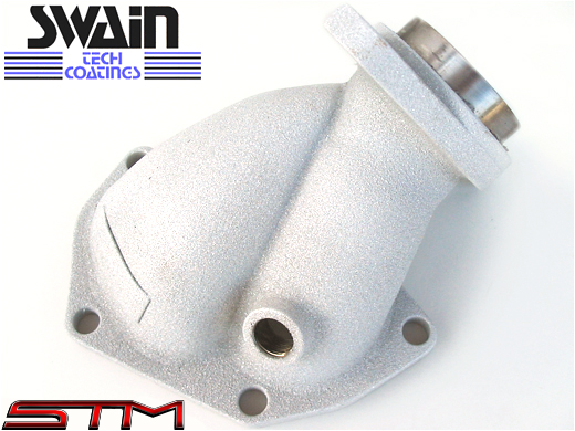

We use a company called swaintech, they have a nice thermal coating, we usually send our customers parts there. Also Tirado Custom Coatings has a lot of new thermal coatings he offers.
Heres a pic of the swain tech coating.
