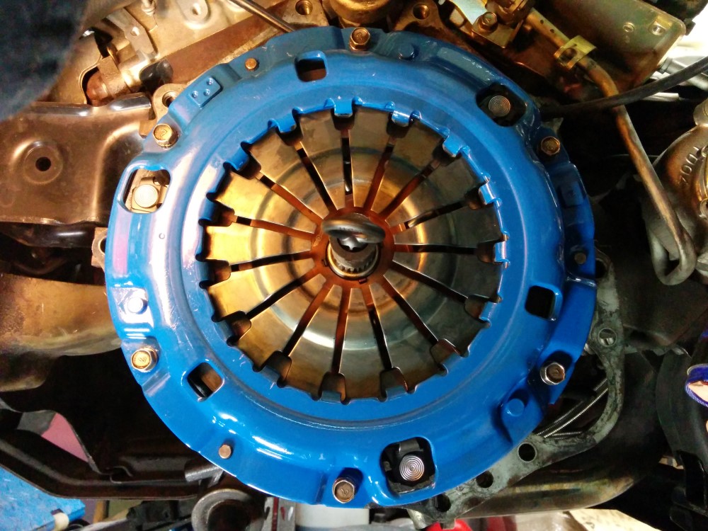

    Didn't get as much work done as I had hoped this weekend due to various family duties I had to take care of. But at least I got time to install the new clutch today.

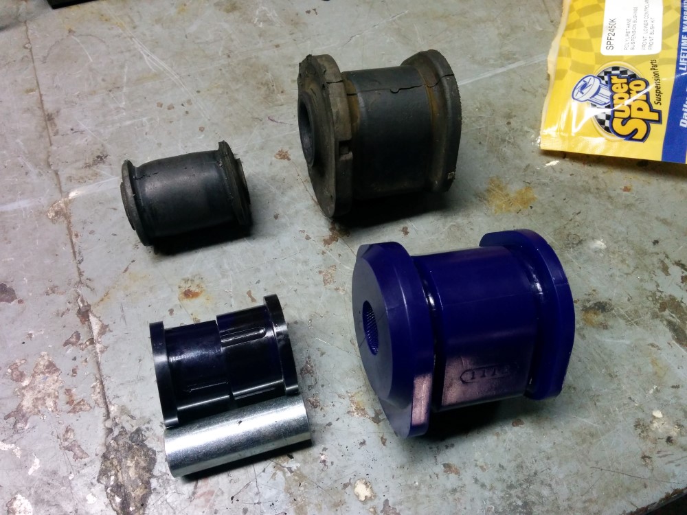

  6. #196
    Oct 2011
    Sundsvall, Sweden
    928
    330
    Thanked 119 Times in 77 Posts

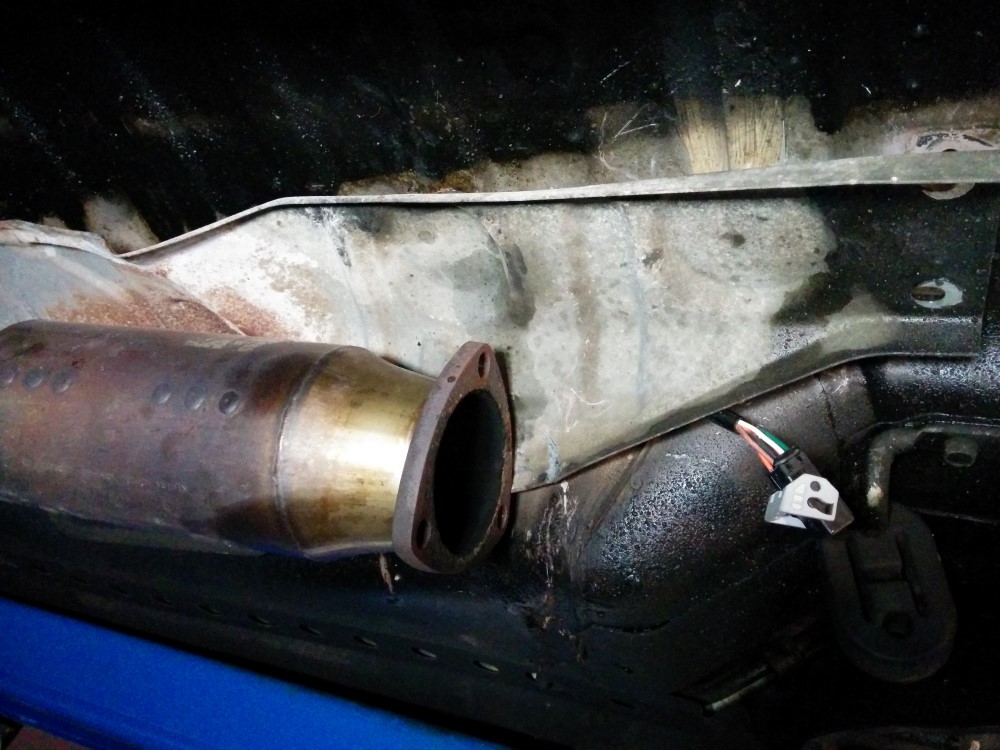

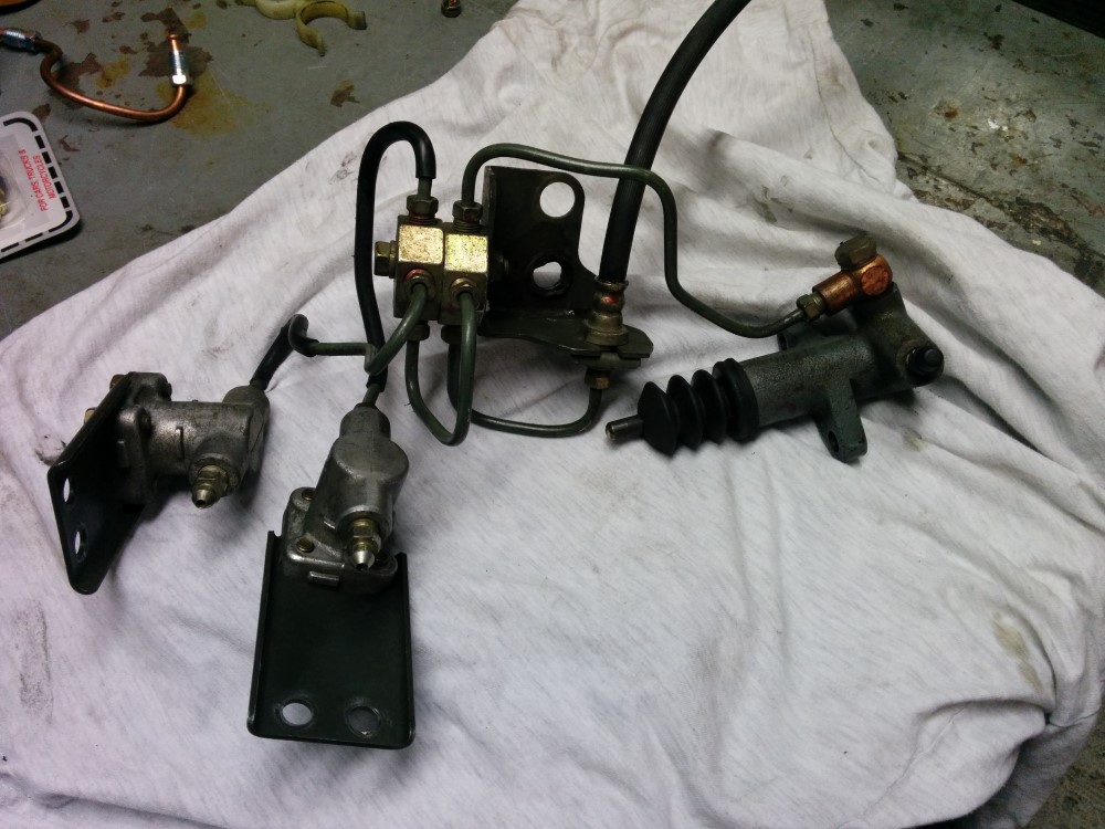

    Got some work done on the car tonight. Started by removing the nest of pipes for the clutch damper. I also removed the small damper/spring hidden in the slave cylinder under the banjo bolt.
    Installed the controller for the AEM WBO2 using the "hidden" grommet under the heat shield (thanks to Jim and everyone else who gave me this tip).
    I managed to get the connector for the controller through the hole in the floor by removing some parts from it and filing down the pegs on the sides about 1mm.

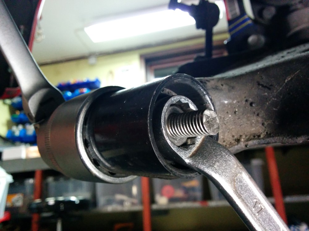

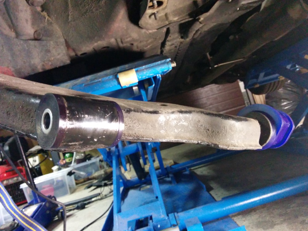

    Before giving up for the night I installed a set of SuperPro front control arm bushings.

  8. #198
    I might have to relocate my wb through that hole as well. How much of a pain was the bushings? I have a set to go in as well...

    Thanked 91 Times in 75 Posts
    I assume that hole is the one used for the JDM single o2 sensor? if so I had to make that hole slightly bigger to fit the HGK wideband sensor through. I put the sensor through not the connector.

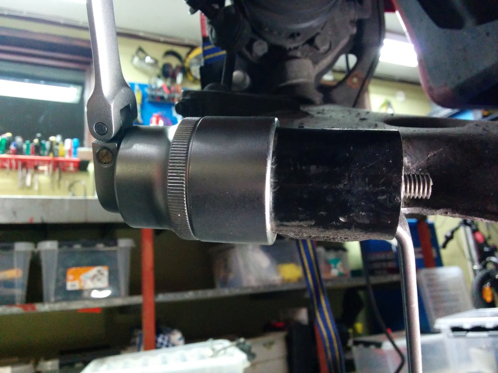

    Oct 2011
    Sundsvall, Sweden
    928
    330
    It was painless, took about 20 min. I used a 36 mm socket to remove the front ones.
