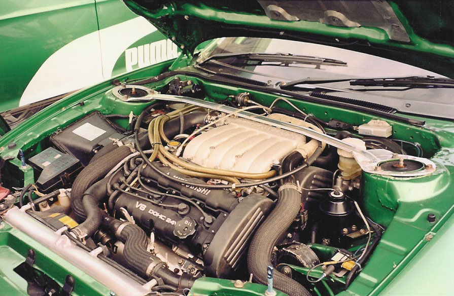

    Lately I have been thinking should I install a simple belt driven vacuum pump where the ac unit normally sits that way I could create the desired 15" of vacuum in the crankcase under all conditions + more power maybe.

    I wonder have anyone done it before is it worth a try ?
    I remember Import Power had electric one in his car back in 2005 or so what ever happened ?
    please share your thoughts.
