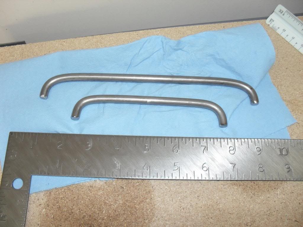

    So before the Texas Gathering begins on Friday, I need to restrain my shoulder harnesses.
    I couldn't find a spec, so I used 5/16" steel rod to quickly make these (driver's side shoulder straps are much wider than the passenger side):

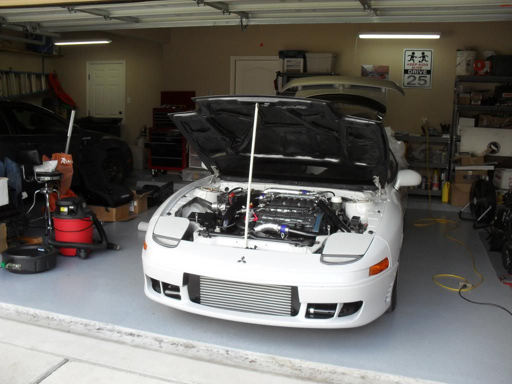

    install & future paint zone:
    As she sat in the garage...

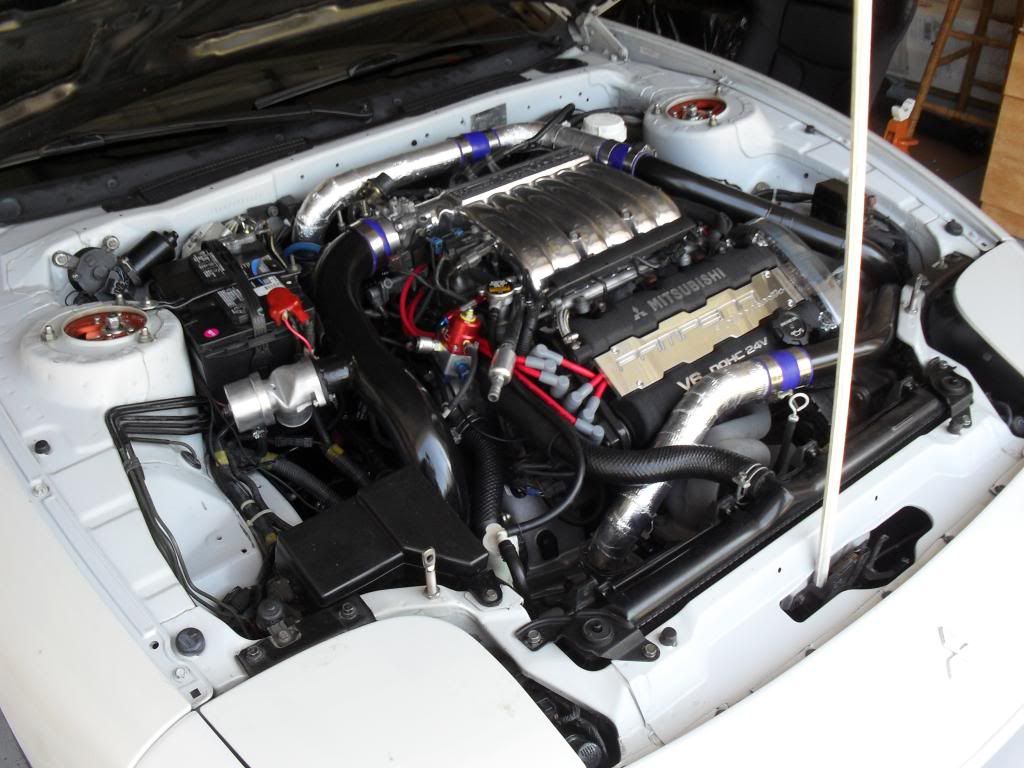

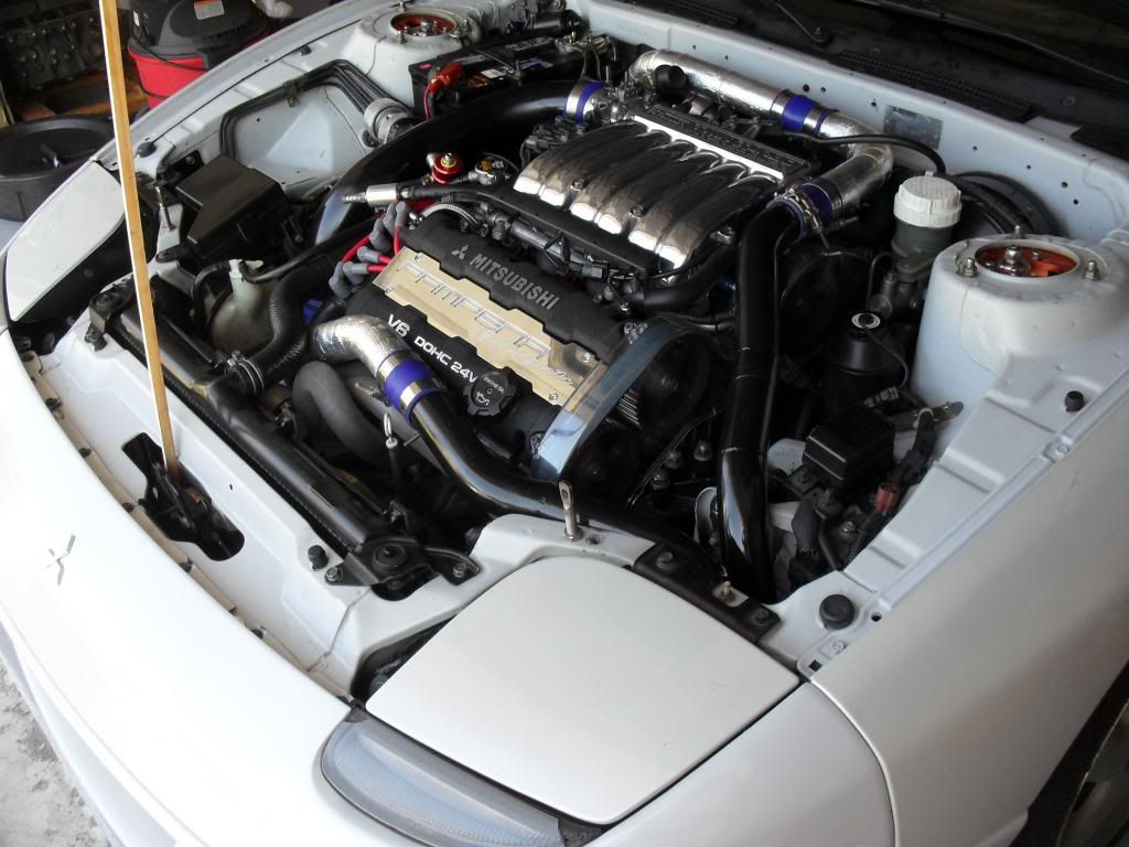

    I reinstalled the windshield wipers, dashpot, and cleaned the engine bay. The entire rest of the car is still covered in dirt and oil.
